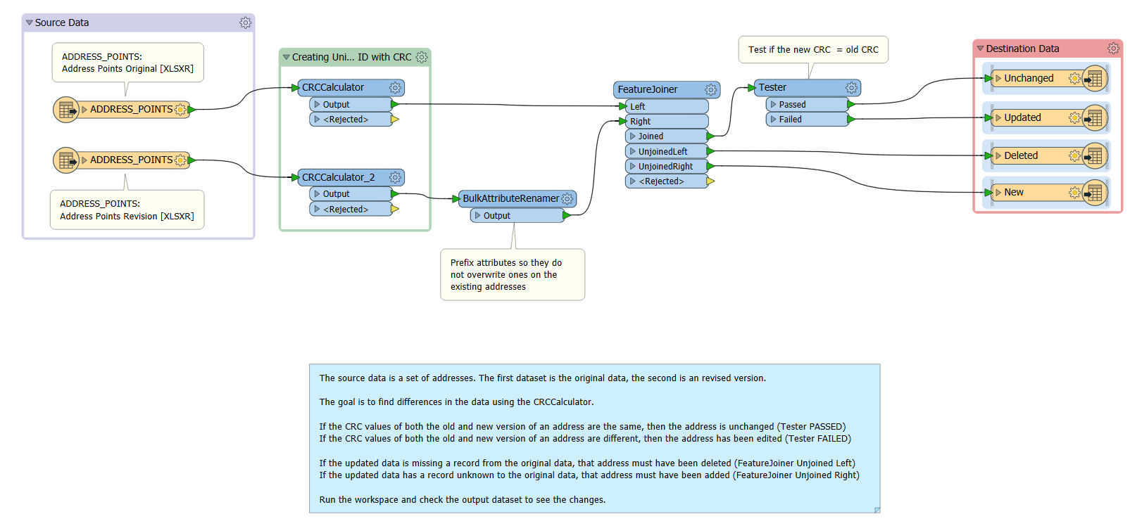

If you’re using the CRCCalculator for change detection that would normally be instead of a changedetector not as well as, e.g.
https://support.safe.com/hc/article_attachments/25408169779341
  • Jan 15, 2025 10:50 AM UTC

I don’t quite get why it wouldn’t work tbh but that seems to be the correct workflow. Thanks!
