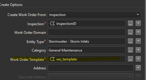

Something we have noticed but have a work around is that the TrumbleUnityConnector will not show work order templates. We end up creating an attribute with the template ID and passing it through that way

Hello! I was able to resolve this by using the additional parameters and setting up API as a JSON.
