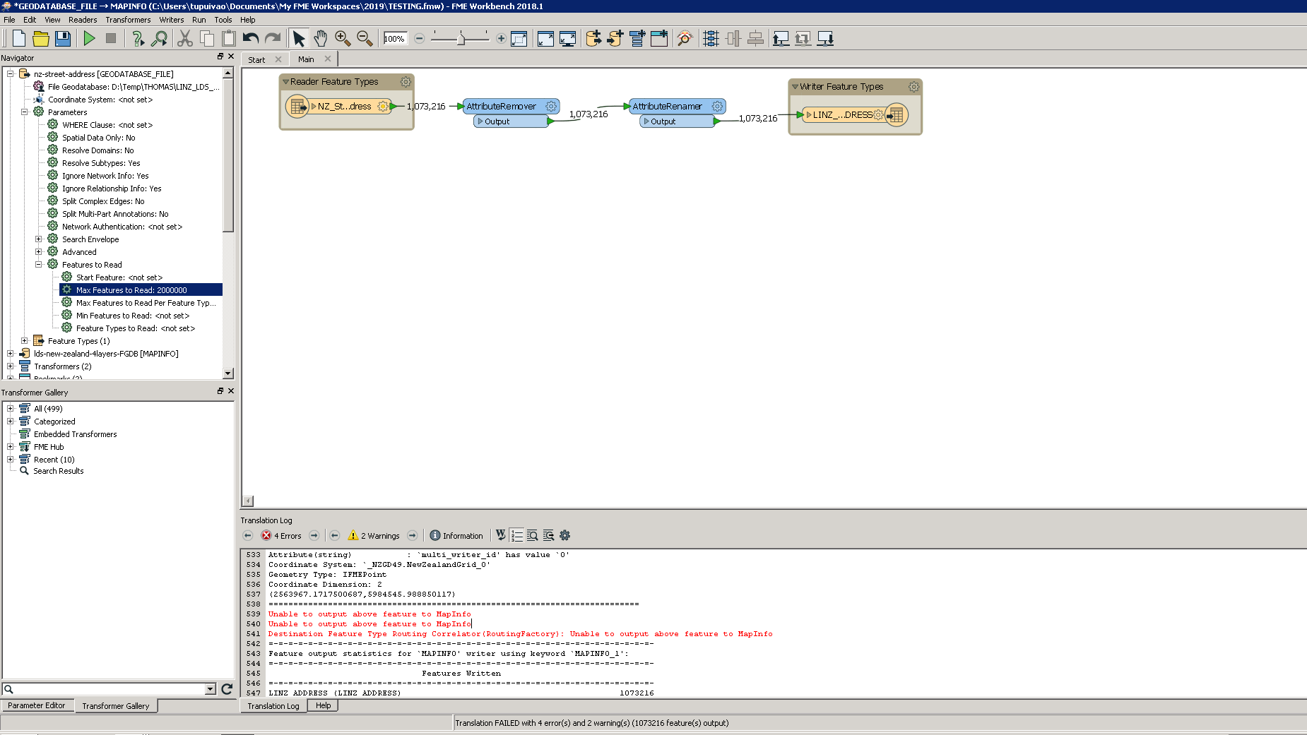

I have a esri geodatabase that I'm trying to translate to a "Mapinfo" table. It is successful if I limit the max features to a million records, but the geodatabase is 2 million records and I keep getting the following error (see image).
I'm running FME on a Windows Server 2008 machine. It has 2 XEON (E5-2670 v2) processors and has 10GB of RAM installed.
I've set the temp folders to the Secondary "D" drive. Not sure why this is happening, as this wasn't an issue when I was running FME 2013. Since upgrading to FME 2018 this has become an issue.

@thomastupuivao I think MapInfo has a 2Gbyte file size limit. You might have to divide your data into parts. Also, ensure that you are not 'wasting' space by having string data types that are longer than really needed. Using Extended Tab would possibly solve this issue.

Hi @thomastupuivao,
Please try your workspace with the Mapinfo (MITAB) to see if you still get the error. This writer uses a different library to write the TAB data, and if it works, will help us pinpoint the source of the error you are seeing.
You may also want to try using the new Mapinfo Extended TAB writer. If you set the Table Type in the writer parameters to Native instead of NativeX, it will write a standard TAB file. This writer uses the latest library supplied by Mapinfo, and should provide the best results.

I've reduced the lengths of my string fields and changed all the fields to float for my "ID" fields. Seems to have done the trick!! Thanks again

Ended up reducing the sizes of my string fields and changing my ID fields to "Float" and it worked??
