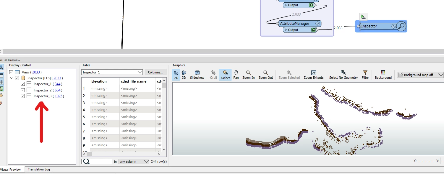

Hi, I'm following the FME Basic course, here exercise Flood Risk Project within the module Use Conditional Value. In the course text the Inspector result is shown in the picture attached here ("... Inspector according to exercise").
However, in my FME the outcome is different (see "... Inspector"): other names and 3 items instead of 5 items.

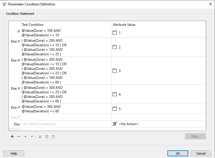

I checked the conditional values used in the AttributeManager several times, it is exact the same as in the course text (see "... Conditional Value"

Looking at the screen shots you've shared it looks like the issue is coming from the 'Elevation' attribute. In your screen shot it looks like the 'Elevation' attribute is missing. Check the rest of the workspace to see why the Elevation isn't getting created properly.
If I remove the 'Elevation' attribute from the workspace I get the same number as you've shown in your screen shot
