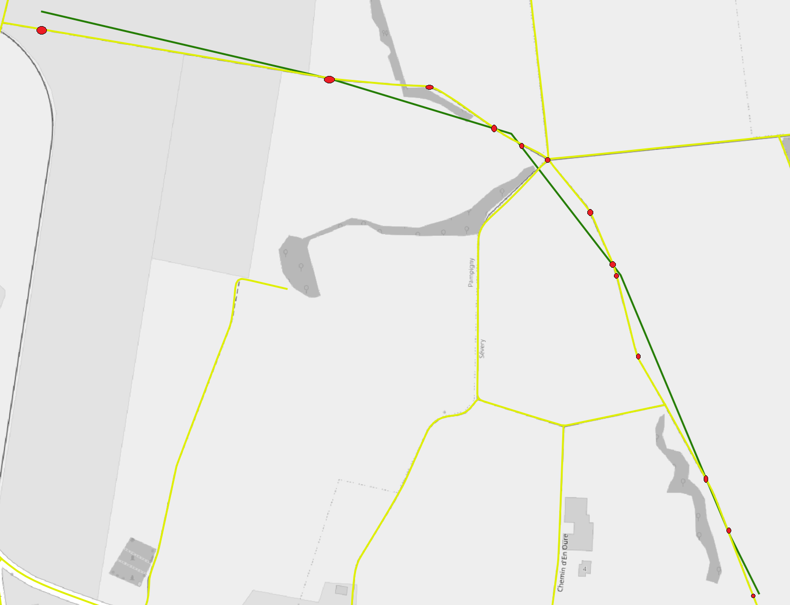

Hi community, does anyone know how to find these points using NeighborFinder/VertexCreator and then create a line with LineBuilder? My goal is to find the shortest route between the "common" points of these two road networks (existing vs planned).

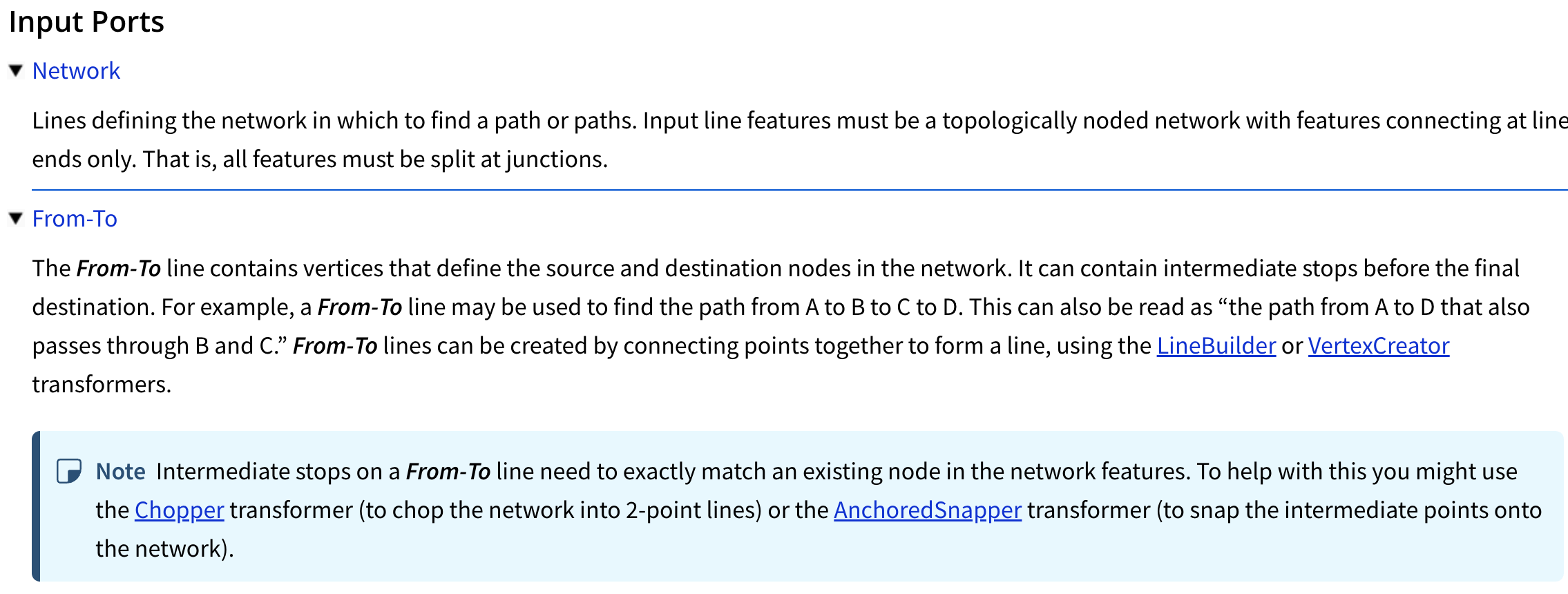

Maybe the transformer ShortestPathFinder?

here is an article explaining https://Shortest-Route-Calculations-with-the-ShortestPathFinder
You’ll need to prepare the inputs:
and consider these usage notes
  • If ShortestPathFinder produces unexpected results, consider using AnchoredSnapper instead. Input the From-To Line through the Candidate input port and use the same value for Snapping Tolerance. Specify Snapping Type = End Point Snapping and Add Additional Vertex = NEVER.
  • Only linear features with non-negative cost attribute values are allowed if the Cost Type is set to By One Attribute or By Two Attributes. If a feature does not have the attribute specified in the Forward Cost Attribute or the Reverse Cost Attribute, a zero cost is used for the line. Any features with a negative cost will be output through the <Rejected> port.
