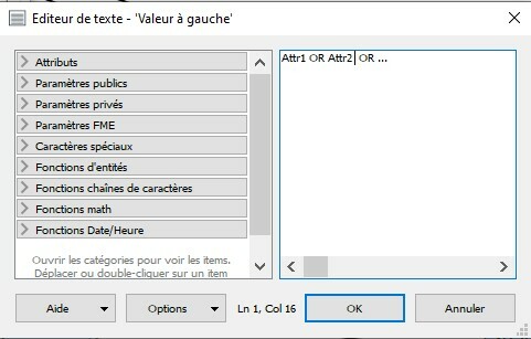

Hello,
I want to know if 90 columns have NULL values.
How can I use Tester Transformer without testing each attribute one by one.
Can I use the Text Editor and write it directly and how ?
Thank you !

Yes you can. Fold out "Composite Expression" and click "Edit".
TesterEdit(2021)
