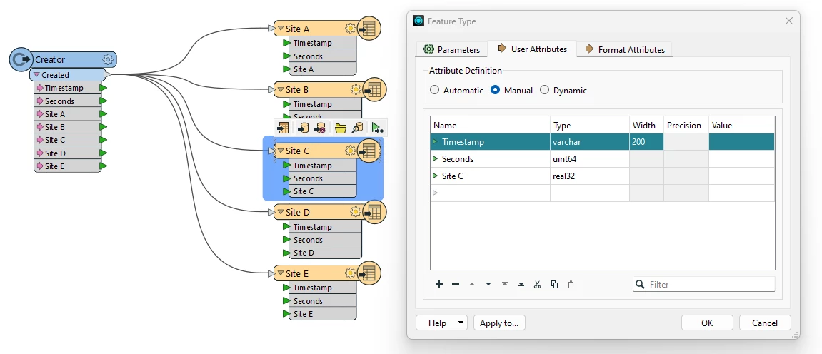

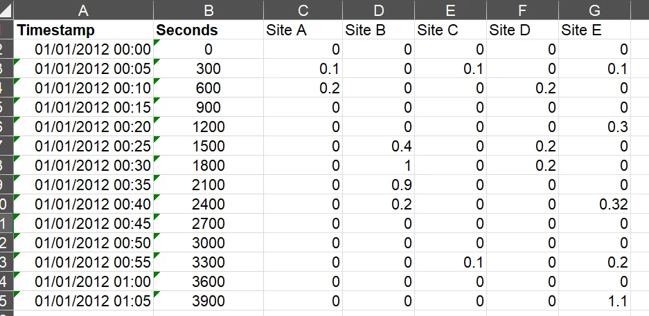

Hi, Screenshot sample of data above: Essentially I have a csv with several sites (columns C-G), to import this data into the software I use, I need to import one site at a time, so i’m looking to split this csv into several csvs which contain the date time columns and then one site column per csv.
I can do this in a convoluted way, using multiple attributekeepers to split the data, is there any quicker way to automate this?
Thanks
Best answer by geomancer
Sure, manually assign what attributes to export to each csv file.

Thanks ​@geomancer! Didn’t think of that at all but seems like it’ll work, cheers!
