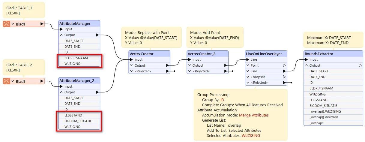

Hi ​@kevinkies ,
If you consider each time duration as a line segment from (date start, 0) to (date end, 0), you can find overlapped segments with LineOnLineOverlayer easily.
Basic workflow would look like the screenshot below. Hovever, I'm not clear detailed requirement about how to keep which value of LEEGSTAND and other attributes from Table 1 or Table 2 in overlaped segments, how to sort resulting rows and so on, so you will have to customize the workflow according to your requirement.

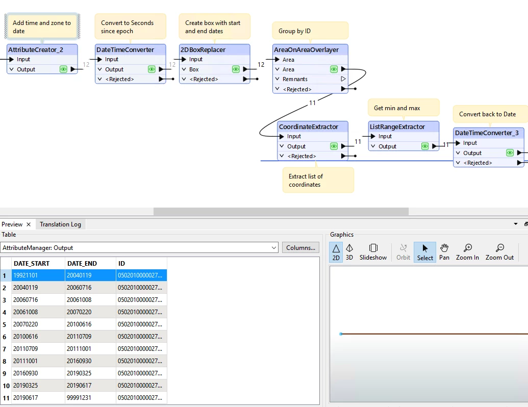

  • Jul 9, 2025 9:13 PM UTC
You could do it spatially, convert dates to seconds since epoch, use that to create boxes, spatially intersect those with an areaonareaoverlayer, get the min and max coordinates which are the start and end dates of each segment in seconds and convert that back to a date

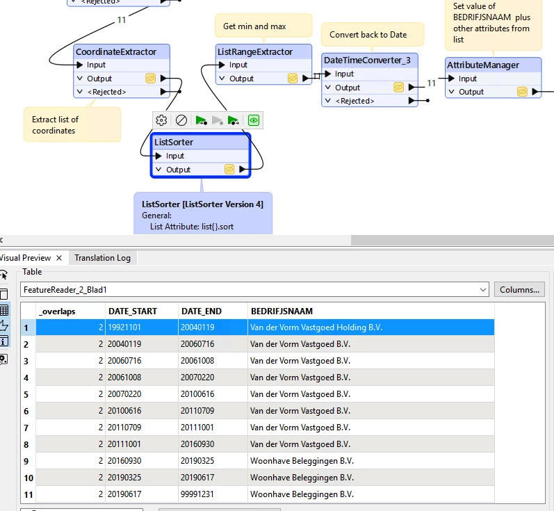

  • Jul 10, 2025 9:52 AM UTC
But in Table2 there is record that goes beyond 20040119 which also has a value of Van der Vorm Vastgoed Holding B.V. ?
In the AreaOnAreaOverlayer, you can choose to drop the attributes in Accumulation Mode and then build a List with the attributes and then use some logic to choose which value of BEDRIFJSNAAM you want to keep (I’m afraid i still don’t understand how you arrive at this so can’t help there!)

​@kevinkies
it works but indeed with no attribute so for. And i need them.
Overlapped segments will have two attribute sets from Table 1 and Table 2, and they all will be stored in a list attribute in my workflow example. I don't know which one should be kept finally, so the workflow is unfinished, as I told you that you will have to customize the workflow.
What are the rules for transferring the source two attribute sets to overlapped segments?
  • Jul 10, 2025 10:58 AM UTC
If you want the values from Table 1 to take precedence I think if you add an attribute to your input, e.g. sort and give a value of 1 for Table 1 and 2 for Table 2, you can then include this in the list you build in the area on area overlayer, sort the list on this value and then set BEDRIFJSNAAM like this

takashi
  • Jul 10, 2025 2:02 PM UTC
I updated the workflow according to the rules.

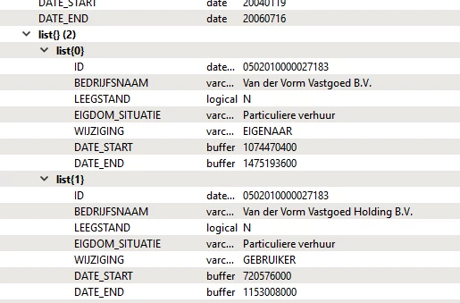

takashi
  • Jul 10, 2025 8:54 PM UTC
I think it's possible, if you would clarify how you can determine which "WIJZIGING" value - from table 1 or table 2 should be assigned to the resulting segment.
takashi
  • Jul 11, 2025 2:59 AM UTC
In my observasion, it seems that the condition to adopt WIJZIGING from the table 1 in the resulting rows is, DATE_START in the resulting segment is equal the DATE_START from the table 1. If so, this workflow might help you.
