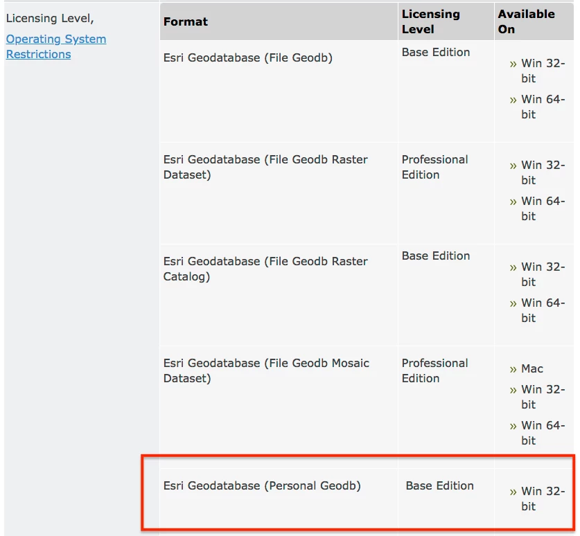

@sdlasiter
Ahh I think that is your issue then. GEODATABASE_MDB is only supported by FME 32 bit :
https://docs.safe.com/fme/html/FME_Desktop_Documentation/FME_ReadersWriters/geodatabase/quick_facts_geodatabase.htm

Been my lucky week I guess......Looks like I'll have to convert to something else before trying to load it now.

Hi @sdlasiter. Another option to consider if you are able would be to install FME 32-bit on the same machine as FME 64-bit. It's possible to install multiple FMEs on the same machine
Article about installing multiple FMEs: https://knowledge.safe.com/articles/796/installing-multiple-versions-of-fme.html
2017 Downloads: https://www.safe.com/support/support-resources/fme-downloads/archived/
