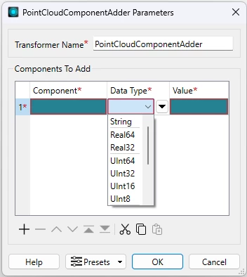

The PointCloudComponentAdder allows you to define the DataType, along with AttributeManagers

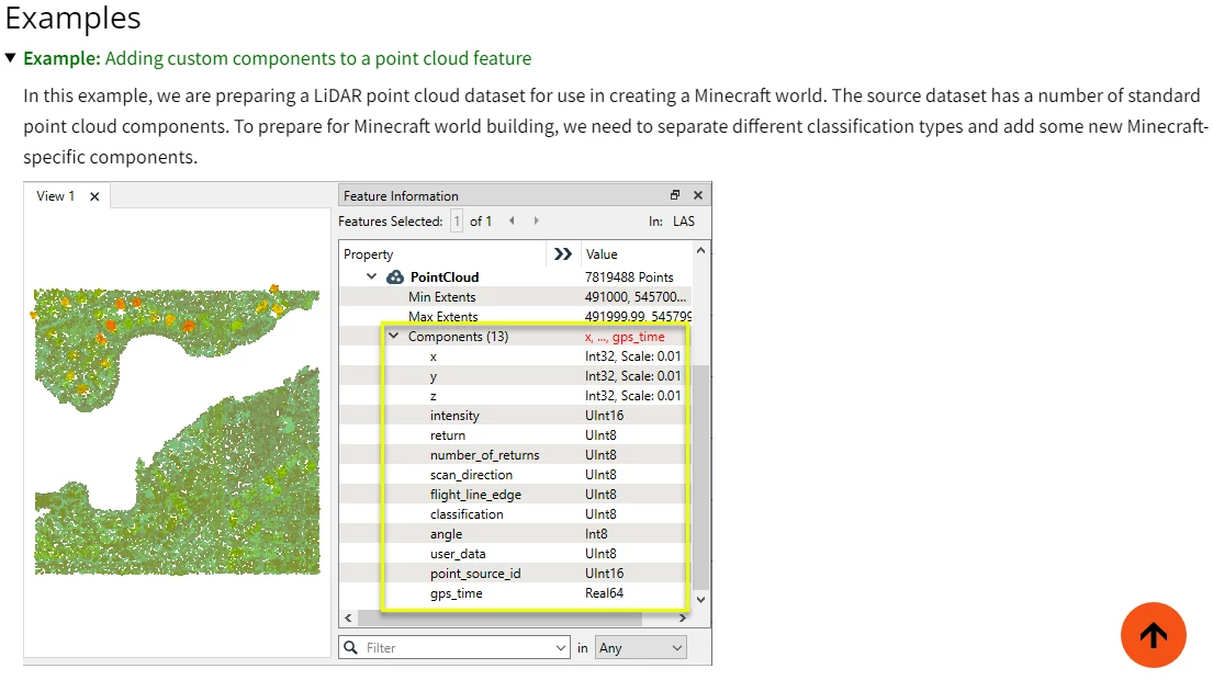

example - make sure you use the Feature/Record Information tab when inspecting the Components

OK, using the PointCloudComponentAdder did work to add the attributes as components. It also alerted me to the fact that one of my attributes/components, which was defined to be of an Int8 type, can’t be a NULL value. The error message was formatted strangely though: @AddPointCloudComponents: Parameter '<value>' has value '' which is invalid for component type 'Int8'.  Please ensure the specified value and type are compatible. No error or warning messages from the PointCloudCombiner.
