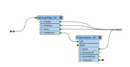

When dealing with Null, Missing or Empty values on either the Left or Right Hand side, use an AttributeFilter like so. AttributeFilter works well because it is bulk mode enabled and is very fast, and as FeatureJoiner is also bulk mode enabled the 2 Transformers combined produce the best performance.

What did you use at the end to merge the result in the example?
The Junction Transformer shown at the end. With FeatureJoiner also set to Left Join mode, the Features arriving at the Junction will be all Joined and Unjoined Left Hand Side features.
