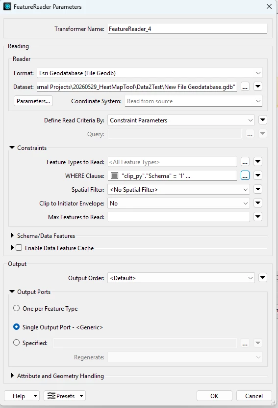

Hi,
I have a file geodatabase (.gdb) containing feature classes, along with an Excel file that includes ArcGIS Pro SQL definition queries intended for specific feature classes.
Example:
gdb with feature classes
ArcPro definition query
Schema = '1' And Rodzaj NOT LIKE '%B%'
I’d like to understand how I can automatically convert these ArcGIS Pro SQL queries into FME SQL syntax. The queries will vary each time and are tailored to individual feature classes.
This SQL works in FeatureReader but it requires a lot of manual work
hkingsbury
Forum|alt.badge.img+73
  • Jun 2, 2026 8:26 PM UTC
The underlying isssue here appear to be that you’re not specifying the featureclasses from the GDB to read, therefore you’re needing to specify the table qualifier in the where clause, so the reader knows where to look for those fields.
I can see two approaches here (assuming you need to dynamically specify the Feature Type/featureclass):
  1. ensure that the excel sheet has the featureclass (in a separate column) each sql query relates to. Then you can read in that sheet, using the column the featureclass is in to populate the ‘Feature Types to Read’ parameter in the FeatureReader and the SQL to populate the ‘WHERE Clause’ parameter.
  2. Break down the sql WHERE into each component and prefix the column qualifier with the required table qualifier.
I’d heavily lean towards #1 as that is a more FME Dynamic process centric approach. With #2 you’d risk incorrectly breaking down the WHERE clause unless you over engineered the logic to ensure you’re breaking it apart and rebuilding it correctly.
