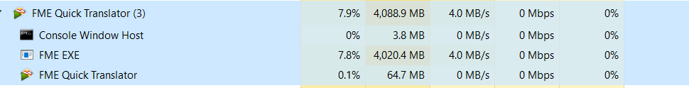

but jumping back to the usage....this is CPU/RAMM/DISK usage while filtering (8 virtual cores) and is very similar for the examples below....

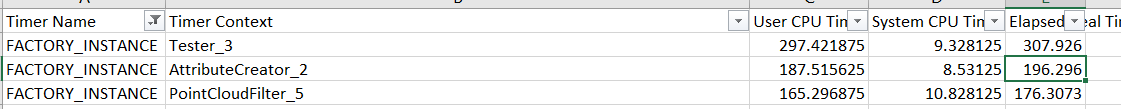

And based on factories...pointcloudfilter is third slowest in this example that has 0.8 billion points
Interesting enough, the tester and attributecreator (running numerous functions such as @Evaluate, @Value, @abs) are way slower (in my other weak part of this process)
