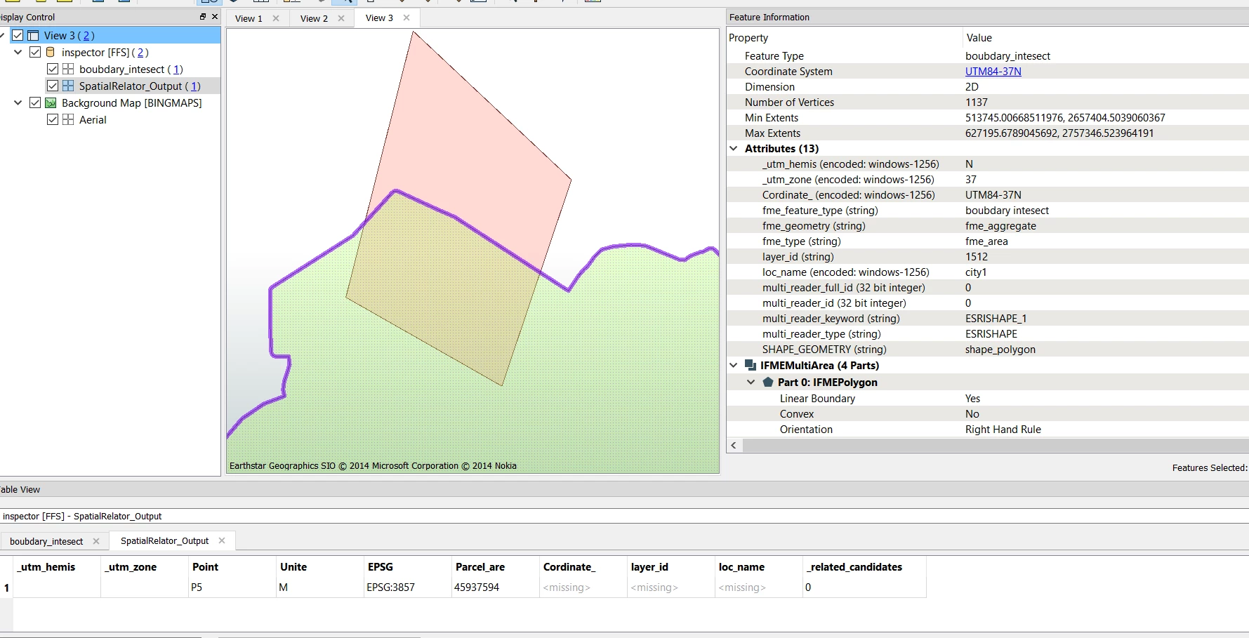

we have a simple WS where we check the relation between 2 polygons we are using the SpatialRelator Polygone, no idea why this not giving the expected result, as you can see there is the relation but the _related_condidate attribute show 0

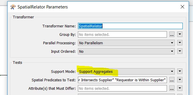

I executed here with sucess. One question is the configuration on transformer SpatialRelator - Please change the option Support Mode = Support Aggregates.

Thanks Danilo
