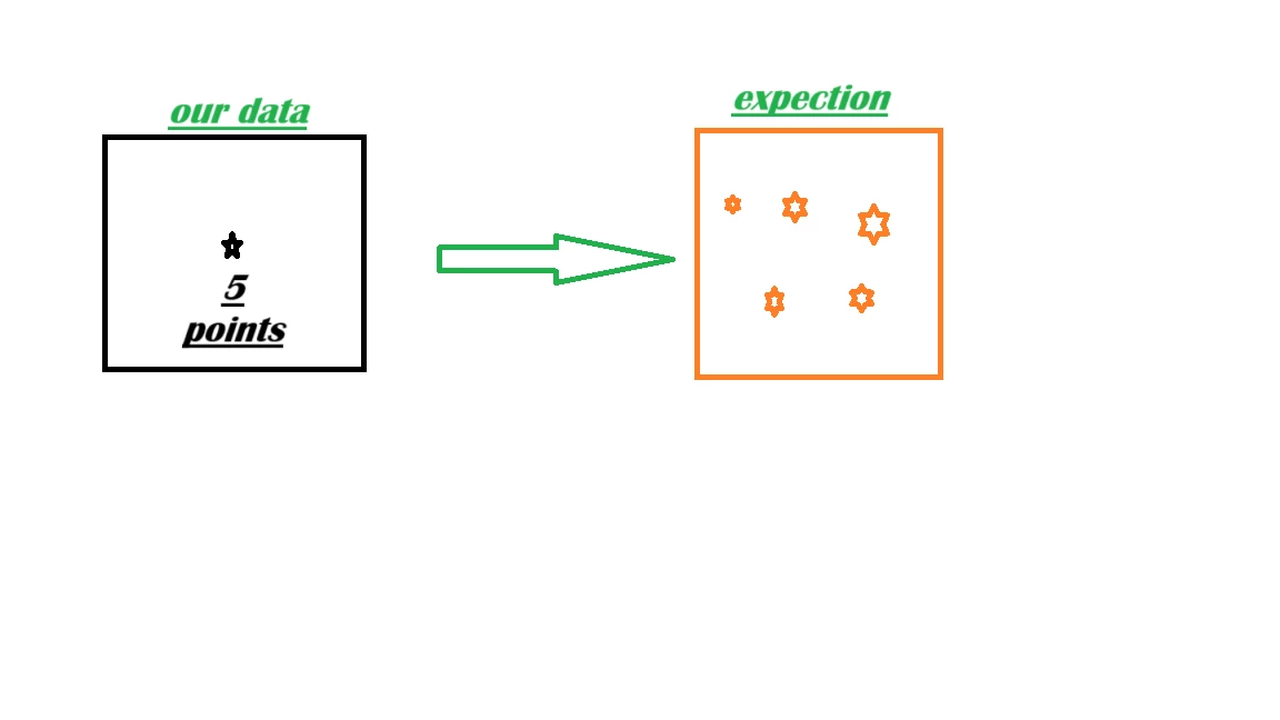

i am trying separate stacked point data in to individual points, can suggest in FME or ArcMap

​@david_r I just need one more piece of information — when using the DuplicatePointSpreader, the points are expanding in a circular pattern. Is it possible to have them expand in a rectangular shape instead?
david_r
  • Aug 20, 2025 2:48 PM UTC
I’ve never used it myself, so I couldn’t say. But it doesn’t look like there’s a setting to specify the “shape” of the spread. But I believe you should be able to right-click on the custom transformer and click Edit.
Perhaps it’s fairly simple to implement yourself?
