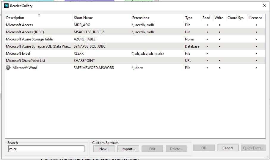

I am upgrading a workbench from 2022 to 2025, this is updating the Schema mapper from 2 to 3, but SchemaMapper version 3 does not appear to have Microsoft SQL Server as a format type. Am i missing something?
SchemaMapper Version 3
SchemaMapper Version 2

Interesting, I can confirm i’m seeing the same on my side. I think it’s worth raising a bug on this.
One work around would be to use the JDBC reader

Thanks Hamish,
Just what I was thinking.
I will try the JDBC reader and I was able to copy the upgraded Schema Mapper from another workbench that was already using Microsoft SQL and it stayed available. So looks like a missing reference in the selection list. I’ll pop in that bug report.
​@hkingsbury
Bug Report - https://support.safe.com/hc/en-us/requests/57317
