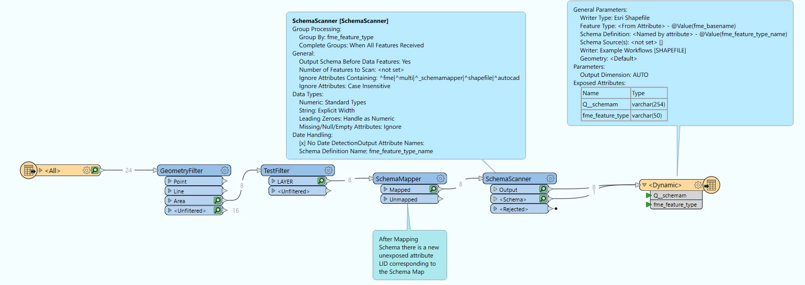

Hello,
A DWG is converted to SHP with a Schema Mapper and Schema Scanner (This is a POC for a more complex workspace.).
Output File
  • What is the Q_schemam attribute that is automatically created ? (I removed it from the writer but I am curious about it).
  • How do I remove the original attribute from my Schema Mapper ? I selected ‘Source Attribute: Remove’ in the schema mapper, but the original attribute is still outputted.
  • My output also contains Source Bra and Source Fea, how do I avoid writing this attributes? What are they ?
Thank you

Hi ​@geodances this might be a situation where we need more information. I’m not really sure where you are getting those attributes either as those are not FME specific or DWG specific attributes.
If you are able to provide the following we would be able to better help:
- Any relevant screenshots (e.g. SchemaScanner parameters, configurations of the writer, etc.)
- Please provide a sample of the source data used in your workspace
- The workspace (or sample workspace) If possible please send this as a template (.fmwt).
If this is critical to your production perhaps you could submit a ticket so that our team can look into this further with that information. Sorry for the inconvenience!
