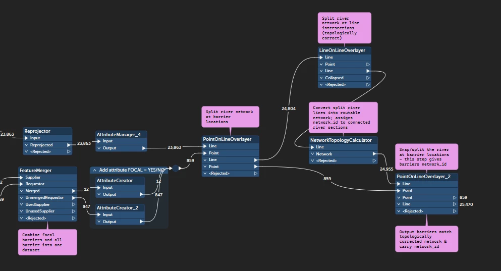

I want to calculate upstream and downstream distances along river polylines between barrier points.
I’ve got as far as generating a topologically correct river network divided at barrier locations, river intersections and junctions complete with network_id.
I’m stuck on the next steps! The main challenge is what to do upstream when a river branches out.
Any help would be greatly appreciated!
Process so far

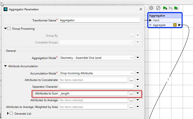

There are a couple of approaches here:
I would begin with LengthCalculator of each individual distance between break points. If you need a total length of all segments, then just use StatisticsCalculator/Aggregator(Attributes to Sum:) and get one feature with total length.

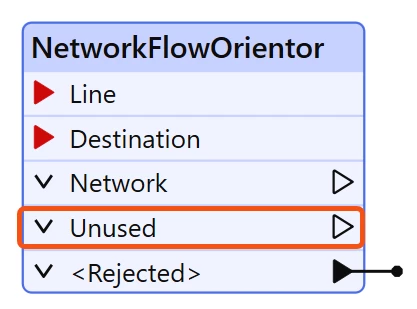

NetworkFlowOrientor only allows one destination node per group, and it doesn't handle cycles well, so if any part of your network is a braided section that splits and rejoins downstream, it might not produce desired results. Are you seeing any of your barrier points or extra nodes coming out the Unused port?

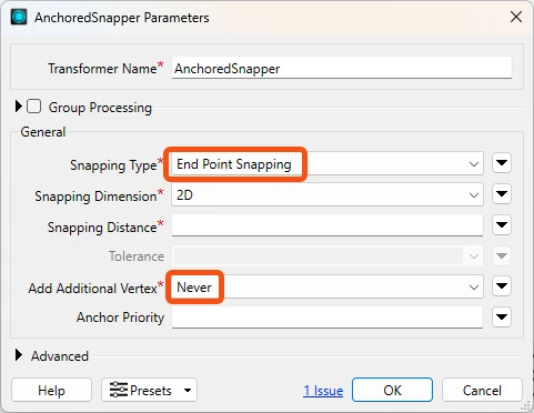

For ShortestPathFinder and NetworkCostCalculator, both need their source/destination points to land exactly on a network vertex. You could try running an AnchoredSnapper (End Point Snapping, Add Additional Vertex = Never) and see if that helps.
