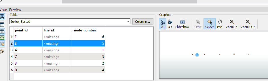

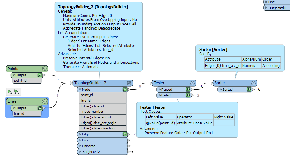

You could potentially rely on TopologyBuilder
It will split a line in the order it encounters overlaying points along it, and can output each split Edge ID as an attribute of the Node.  This allows the Nodes to be sorted by the Split Edge IDs which will be the order they exist along the original Line.
Use something like AnchoredSnapper as an addition to this to snap the Nodes to the Lines if need to before TopologyBuilder.
In sample data, I used a random order of Points on a Line, but the Sorter by Edge(0) ID has reordered the points such that the Eg. 2nd Feature out of the Sorter is the 2nd Point along the Line.
So even though Point “E” was the 5th Feature that entered the TopologyBuilder, it became the 2nd Feature that exited the Sorter, which corresponds to the order it existed on the line.

I believe your idea works well.
Does this mean that later I should use feature merger to get point id (output of sorter) on  the edge ?
First Feature merger : Requester ( from node ) ,Supplier ( node_number)
then connect merge output to second feature merger ( Requester to_node  , supplier node number) ?
Is that correct, or is there another method to obtain the reordered point ID on lines and determine which point is located on each line?
