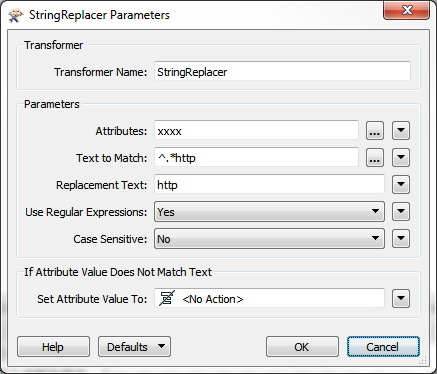

Forum|alt.badge.img+5
There might be better ways (other users, please do point them out) but for a quick solution I went with a StringReplacer:
Match: ^.*http
Replacement: http
Might be a bit limited - for example what happens if there is more than 1 URL - but is a starting point
Match: ^.*http
Replacement: http
Just a heads up, this won't work if there is some text after the URL :-)
Good point.
