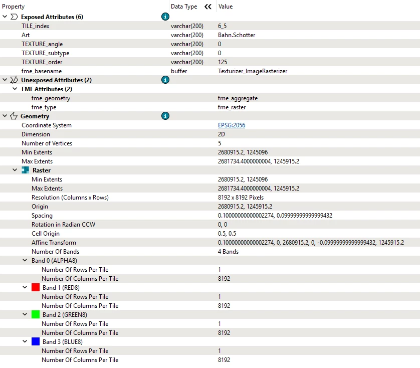

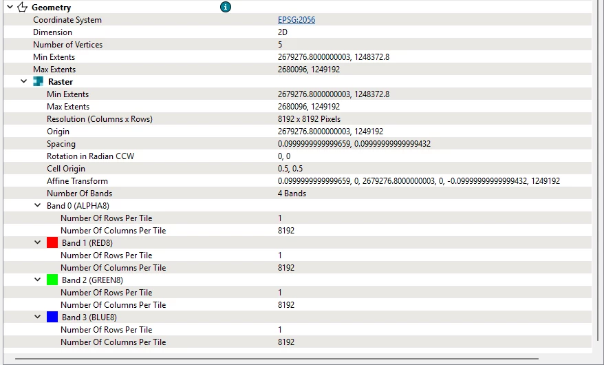

Here are the screenshots of the details of the two input rasters, each with an Alpha8 and RED8, GREEN8, BLUE8 band.
I’ve also tried the RasterBandNodataSetter as well as the RasterBandNodataRemover, but the Mosaicker fails regardless. None of the bands have a palette.

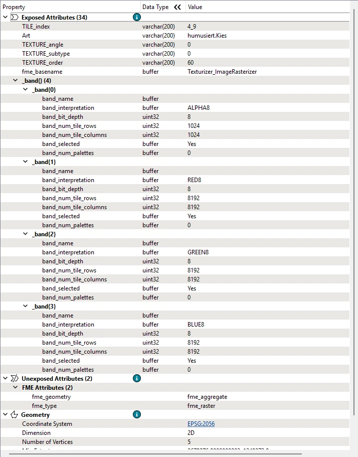

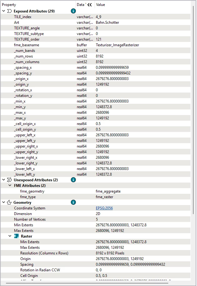

  • May 15, 2026 12:56 PM UTC
Both rasters seem to have the same values.
Only thing that seems to be different is the attribute band_num_tile_rows / band_num_tile_columns which is 1024 for the alpha band and 8192 for the RGB bands. But in the listed resolution of the whole raster it is 8192. And when extending the info about the raster, all four bands are listed with 8192 so idk if this is actually an issue.
