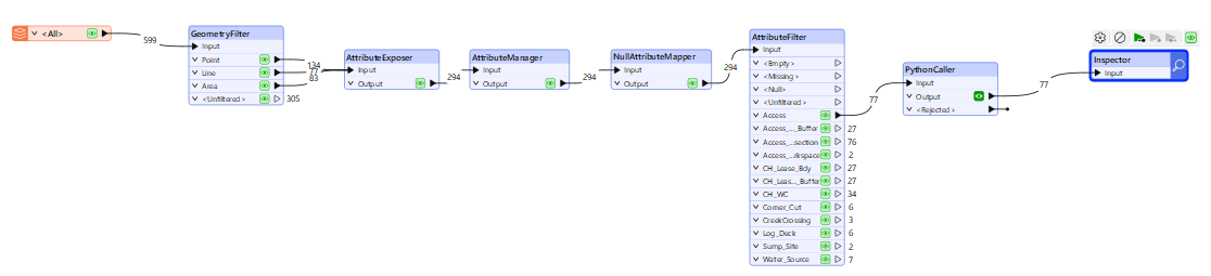

Hi, I would like some help with PythonCaller.  I have a workflow where I read in feature classes from an Esri file geodatabase, combining the features into a single attribute to make it dynamic.  I filter out annotation, resolve domains and rename original domain fields, map empty and missing features to Null, then use AttributeFilter to split by FME Feature Type.
My next desired steps are to identify, for each FME Feature Type, which attributes are nulls, and remove those attributes, then connect all splits to a Writer to write out to shapefiles grouped by FME Feature Type.
I am trying to use PythonCaller to remove the null attributes.  It stores the attribute names in a list, and stores in a dictionary called alnum_tracker attribute names and whether they contain data (where they are saved as True), before comparing the list of attributes to the dictionary, deleting any that are not matches.  I’ve tested it and it is grabbing the correct attributes to delete and keep.  The Python works, and my logged messages output expected results from the data.  However, when I use pyoutput to output features, I get nothing.  No features get outputted.  I get the messages in my Translation Log:
“Destination Feature Type Routing Correlator (RoutingFactory): Tested 77 input feature(s), wrote 77 output feature(s): 0 matched merge filters, 0 were routed to output, 77 could not be routed”
“Final Output Nuker (TeeFactory): Cloned 77 input feature(s) into 0 output feature(s)”.
I’m new to FME and using PythonCaller in FME.  I want to know why I can’t get output features from PythonCaller.  My workflow is shown above, and my code below.

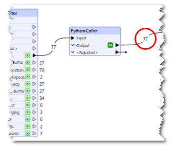

Hi ​@diannebcgray ,
In your screenshot, the Feature Counting indicates 77 features have been output from the PythonCaller. I think the “pyoutput” method in your script works fine.

Hi ​@diannebcgray ,
Yes, 77 features are passed through, with nothing changed and no null attributes removed.
