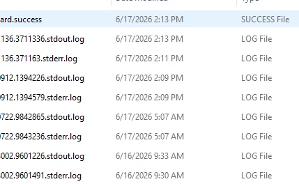

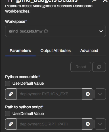

  • On the library point you raised: this isn't a case of not knowing FME's Python can take packages. The script needs arcpy, which isn't pip-installable — it ships bundled with ArcGIS Enterprise and is tied to that interpreter. So rather than repoint FME's engine Python at the ArcGIS conda env (and drag our other installed libraries into an env we don't control), we keep FME's default engine interpreter and use a deployment parameter to point the script at the ArcGIS Enterprise Python on the same Flow box. Two interpreters, two purposes.
  • On visibility: it's true FME just triggers it and sees run/fail. The flip side is process isolation — a heavy arcpy/pandas job crashing kills the subprocess, not the engine. We handle that boundary with exit codes (so the workspace tracks failure) and full error logging to a share.
  • Config is all Flow deployment parameters injected via os.environ.get at runtime — which also keeps DB and AGOL credentials out of the repo entirely.
  • For versioning, the script will live in git, cloned to share locations, with Dev and Prod Flow pointing at separate clones so promotion to prod is a deliberate step rather than a shared live file.
As long as error logging is thorough, this has been pretty robust for self-contained work. Agree the PythonCaller is the right call for anything that interfaces with the feature stream.
