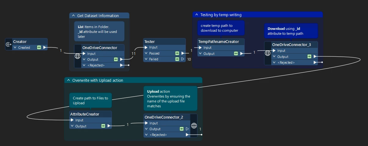

Hi ​@adam_wood! I think you’re on the right track, breaking the actions down a bit. The ID issue you’ve hit is common with hard-coded references.
You might have an easier time overwriting files using two (or more, depending on what you want to do) OneDriveConnectors. One with the List action and one with the Upload action.
The List action gives helpful attributes like name and id! This should hopefully solve your ID problem. You're essentially pulling the current folder metadata each time the workspace runs.
When it comes to the Upload action and actually overwriting files, this line from the documentation might shed some light: “uploads of the same name, in a specific folder, as overwrites, so if you upload files that already exist in that folder, they will be overwritten by the upload”
I’ve tested this with both files and folders, and it seems to work with overwriting both! The Upload action handles the overwrite automatically when you target the same folder path/name
If this doesn’t help get you to that end goal, if you’re willing to share a workspace (and what version you’re using) or a screenshots that would be great!
