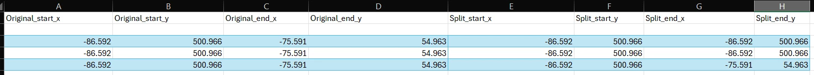

Hi,
I split a line at two points using PointOnLineOverlayer, which generated three segments. I extracted the coordinates before breaking the line and again after the splits.  I was expecting the start coordinates of the second and third segments to be different from the original line's start coordinates, but all three segments appear to have the same start x and y in both split and original coordinates. Is it something with the split that went wrong because i had only one case in which coordinates were different but rest of the examples are showing this, which is not helping. Any feedback would be greatly appreciated! Thanks.

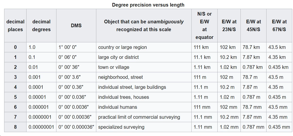

Precision table
Hi ​@fme_can_do_it It looks to me like the precision is low. How long are the lines? If I read this right the precision for where you are is ~60m. What do you see if you run this through the CoordinateExtractor?

​@crutledge Thank you for your response. The length is 1160 feet. Those coordinates are dummy coordinates; I created them to explain the issue.
