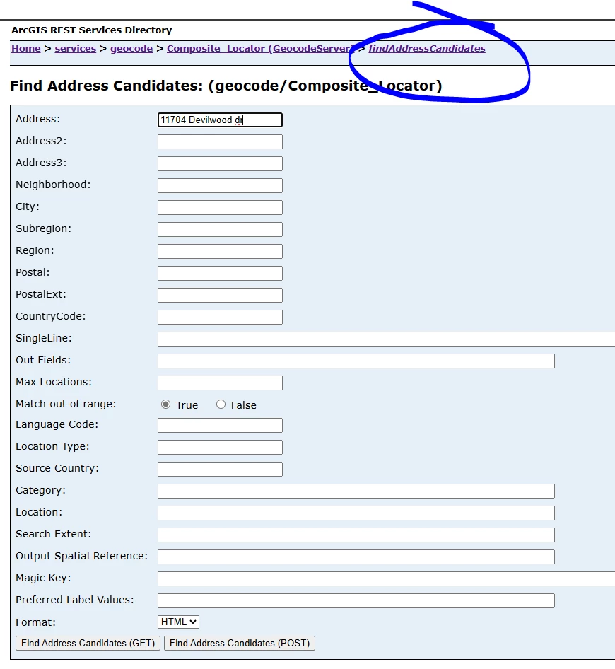

Hello FME Community, can someone help me configure the Geocoder transformer to use our County geolocator service?  I’m using a single-line address, with the locator on an ArcGIS Server.  The URL is https://gis3.montgomerycountymd.gov/arcgis/rest/services/geocode/Composite_Locator/GeocodeServer.  This is a public-facing locator service for Montgomery County, MD.

The County Locator Service works properly in ArcGIS Pro or when an address is presented to the Address Candidate operation at the rest endpoint.

Hi ​@colejo02 Stab in the dark here. Could it be as simple as going one level deeper in the service url for the geocoder?

Hello ​@crutledge, Thank you for your suggestion, adding the next level helped.  The other necessary change was to switch the authentication type to Generate Token.  Thank you for your help!  -Josh
