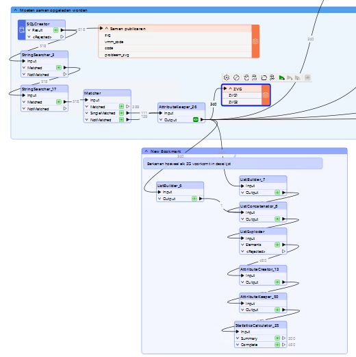

I need to make a model but I honestly don't really know how to start it. I will try to explain.
I need to create groups of “municipalities” whose data should be published together. I already have a list of which municipalities is intertwined with which municipality based on geometric overrides but the same municipalities may be intertwined with another municipality, which in turn may also be intertwined with another etc....
Eg Municipality 1 should be charged together with municipality 3 and municipality 4. I have this list, but then I also have to search in the same list if municipality 3 should also be charged with other municipalities, in this case yes, together with municipality 6 and municipality 7. Then I have to do the same for borough 4 and borough 6 and borough 7 and so on until I have everything and can then make it 1 group.
Is this clear? Can somebody help me with this model or give me a tip how to start it.
I attach a sample of my starting table “Samen publiceren”
I already took out all the duplicates myself and put the codes in columns in the csv and counted how many times each code appears in the table, i.e. how many connections there are.
But how do I connect everything together and make groups?

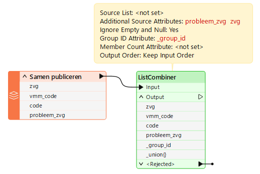

Best answer by takashi
Hi ​@nath ,
If I understand your requirement correctly, ListCombiner from FME Hub might help you. Try it out.
Other than that, there could also be a geometrical solution if the relationships between zvg and probleem_zvg would be determined based on spatial relations between their geometries.
takashi
  • Jun 20, 2025 2:17 AM UTC
Hi ​@nath ,

Thx! You made my day/week.
I have what i needed now
