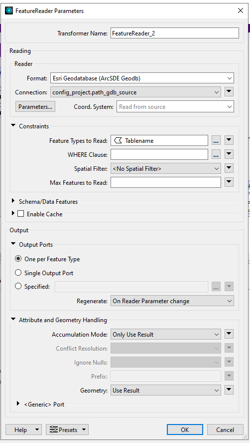

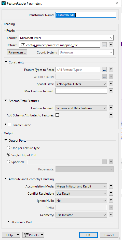

  1. I read the Excel file using a FeatureReader to get the list of tables.
  2. For each row, I use another FeatureReader to read the source table from the SDE using the Tablename attribute.

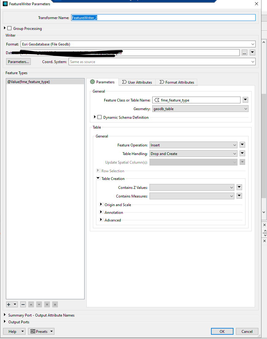

  1. I then use a FeatureWriter, setting fme_feature_type to the value of the Destination attribute so it writes to the correct table name.
The problem:
The destination tables are created with the correct names in the GDB, but they do not contain any attributes from the source tables only OBJECTIDs.
What am I missing here? My tables are in Excel and will be dynamic, so I can't simply explode all attributes manually.

You may need to read up about  dynamic writing in FME to achieve this.
You may need to connect the schema port of a feature reader from source SDE to the Feature writer.
Inspect the data stream going into the same feature writer and ensure the FME Feature Type is indeed matching that of the schema stream. You may need to feature merger between using the excel data stream to swap out the names.
On the feature type Feature writer, you need to define the schema definition source… then check/remove all the records in the ‘Dynamic’ attributes tab, adjacent the user attribute definition… which you are overwriting with the schema from the feature reader SDE source.
NB. the schema port of the feature reader has the schema in a “list” attribute{}
