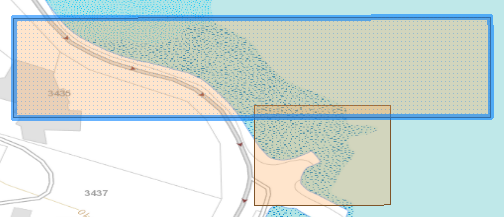

I have a set of approx 2000 rectangular polygons I need to offset where overlaps exist.
Approx 50 have overlaps as below.

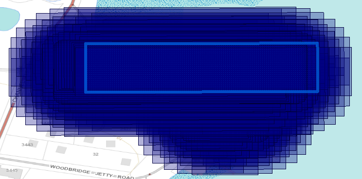

I'm using a custom transformer written by somebody else in this forum to create
offset candidates. This has 2 numeric fields I can use to find the optimal offset
location i.e. distance and angle (closest to the right). These could be incremented
in a loop for e.g. until no overlaps exist. e.g try a counter clockwise loop of the closest
set and if overlaps still exist then try the same on the next closest set until a
non overlapping candidate is found.
