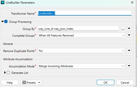

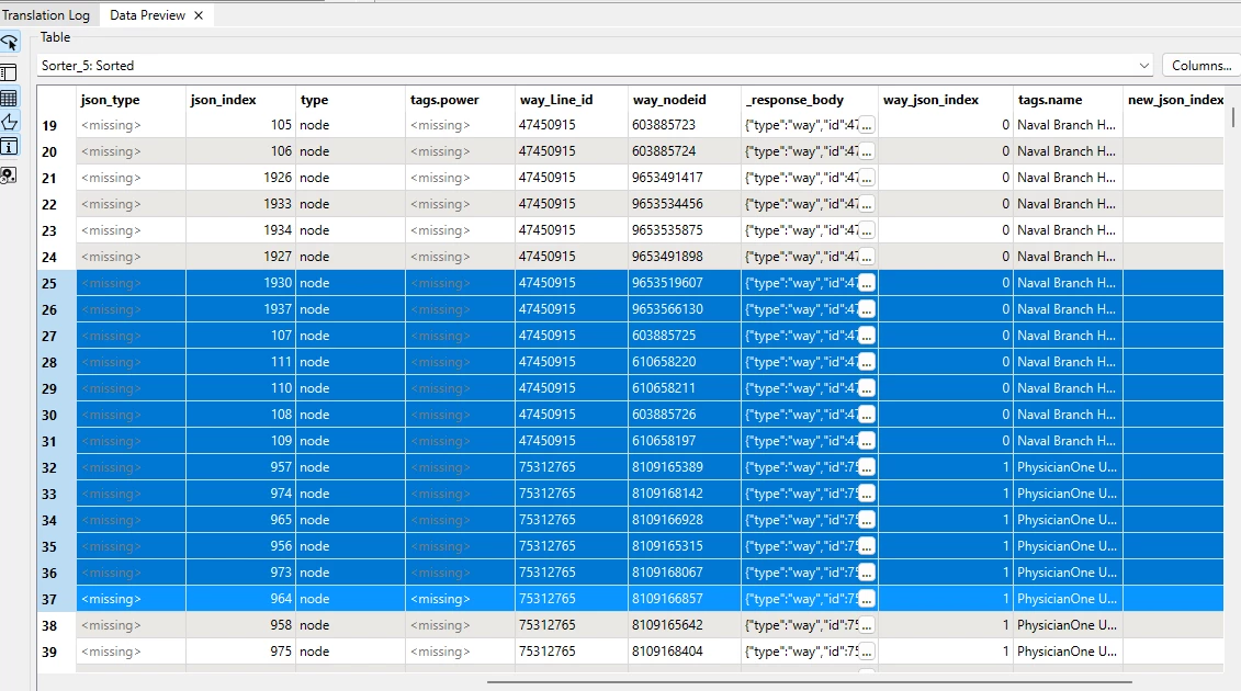

I am using the same workflow that I used in my older version of FME workbench. When I update the FME workbench to 2026.2 I was started getting error in Line Builder. I have number of points that create a polygon. All the points are already sorted. Can anyone let me know is this the bug or something wrong. You can see in the screen shot like waylineid is common and wayjsonindex. if there are 96 features then there will be 96 way_json_index.

Best answer by daveatsafe
The combination of an update to FME to better handle multiple geometries and the FeatureJoiner being set to retain both geometries resulted in features being submitted to the LineBuilder with both Point and Null geometries on them. These are rejected, causing the workspace failure.
Adjusting the FeatureJoiner to only keep the Left (point) geometry fixed the issue.
