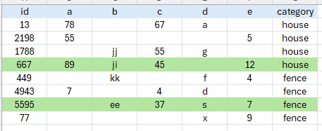

Good day,
I have a table with a couple of records.
I would like to keep one record per category and this record should be the record which has the less attributes with a null (missing) value (I highlighted them in green on the screenshot.). How can I automatically calculate which record per category I should keep?

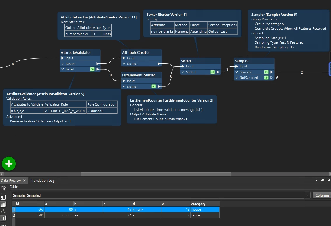

One possible way is to use the attribute validator to check whether attributes have values, count the resulting list which is in effect the number of missing values for a row and sort by this, and keep only the feature for each group that has the least number of blanks
