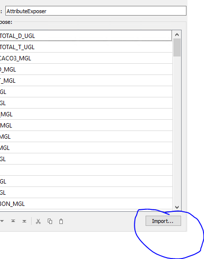

I am using AttributeExposer (AE) and need to import the values from a table. I do not know how many values there are before I run the workspace, so I need to be able to import the values from a table created by the workspace.
I thought I had it all worked out and then realized that the "Import..." option might not be "live." i.e., it worked the one time and has been holding onto the values I entered, rather than repopulating with a newly created table each time.
Is this true? Is this "one and done" and you need to manually reload these values if the table you loaded them from changes?
I need to do this after I use AttributeCreator, because the attributes that are created are invisible. If there was way to create attributes and have them be visible, that would be wonderful.

Yes, you are right.
The Import function on the AttributeExposer (as on other transformers) is static in a way that it imports the values into the workspace, but does not update automatically when the source changes.

Yes, you are right.
