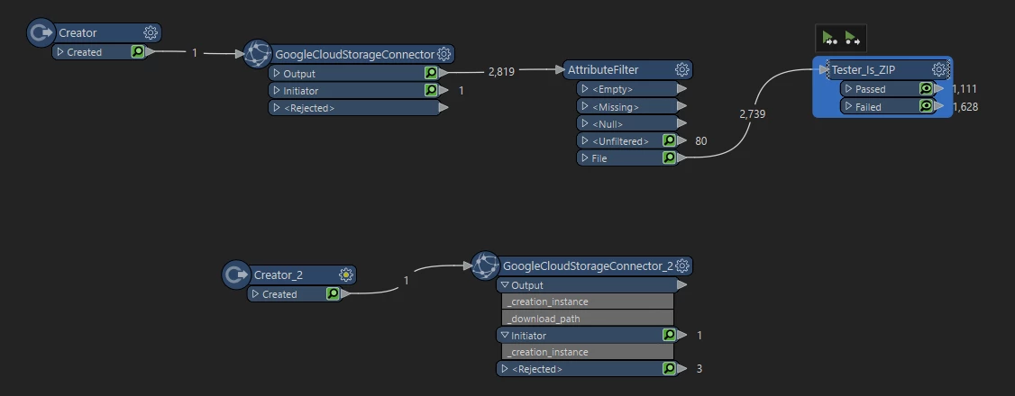

I am trying to set up a process that downloads new zip files containing shapefiles from a Google Bucket. The bucket contains four folders at the top level and in each of those folders are folders for individual project areas. In those project folders there are mp4s, pdfs and zip files with the shape files. I would like to just download those zip files, and keep them grouped by project, and none of the others every time the flow is triggered. So far I have figured out out how to list the files and filter out everything else not a zip file. The list is great but I want to download them and not just list them. This is my first time working with Google Cloud Storage buckets.

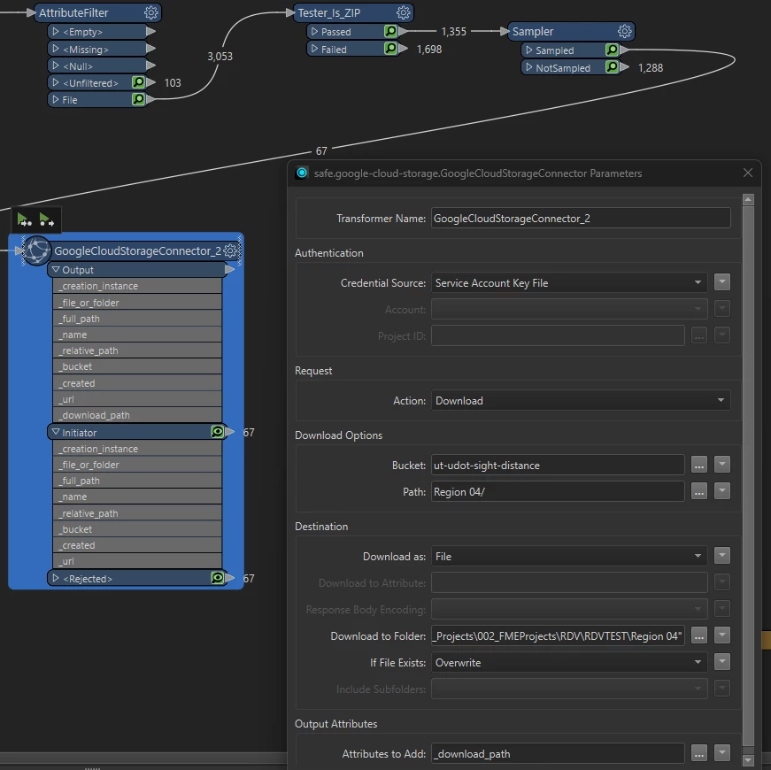

How do I feed that path into the second GoogleCloudStorageConnector? This connector has got me stumped. I have fed the sampled list into the connector and then set it to download as a file to a local test folder and I am not getting anything to download in the destination folder. Any suggestions?
j.botterill
Forum|alt.badge.img+69
  • Jun 25, 2025 11:41 PM UTC
Following the connector transformer,  which currently has an output called _download_path, place a featureReader
read downloaded Google Cloud Storage data using the FeatureReader, or upload data written by the FeatureWriter to Google Cloud Storage
With the FeatureReader, specify the main format you are downloading from GoogleCloudStorage and the dataset will be _download_path attribute, selecting the down arrow to find the initator attributes
