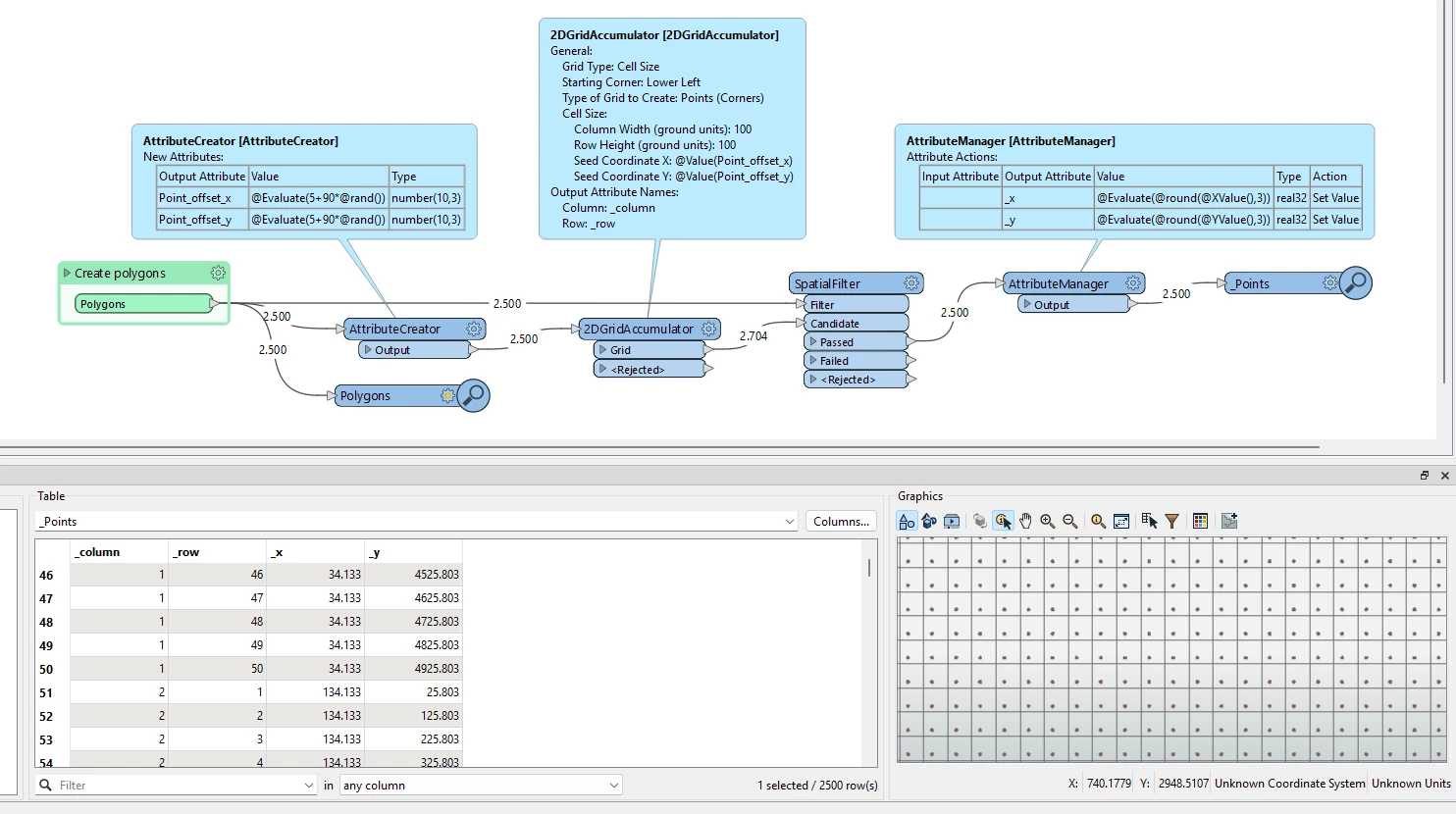

Does the 2DGridAccumulator give the results you want?
Every point is placed at the same relative location within its polygon.
That image does seem to be what I require. Will test and report back, for 10 points would that be 10 separate implementations of the 2d grid accumulator?
geomancer
Forum|alt.badge.img+71
  • Jun 3, 2026 10:33 AM UTC
Yes, processing 10 separate points can be done with 10 2DGridAccumulators.
Alternatively you could add 9 Offsetters or 9 VertexCreators after the SpatialFilter to move the points to another location.
