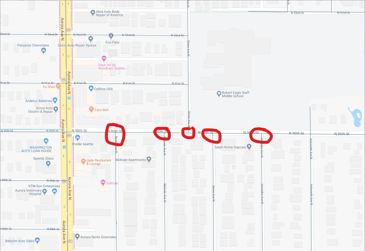

Hello everyone,
I have a street centerline dataset and I would like to identifying where there are T intersection (3 centerlines intersect at same point). Here is the image and I would like to find the highlighted lines.
Thanks in advance.

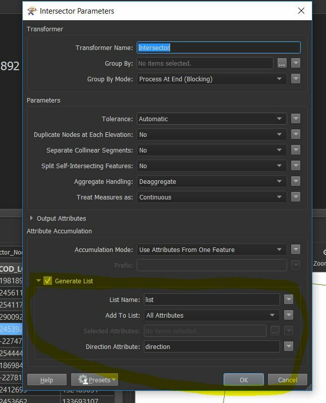

Hi @jugoslaviaa
Just for complement my answer - inside the transformer Intersector there is the option Generate List, please check this option and create a List of elements:
And after this transformer - you can use the transformer ListElementCounter ( like suggest you @daveatsafe ) then the transformer Tester to filter the number of elements that you want = 3.
Thanks,
