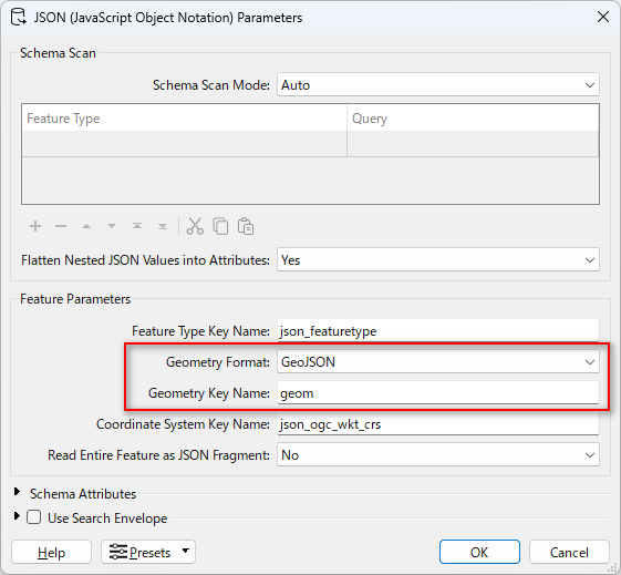

Best answer by takashi
Hi ​@cbates ,
Since the "geom" object in the JSON document conforms to syntax of "geometry" in GeoJSON format, you can use JSON reader to read the feature including point geometry with reader parameters setting below.
  • Geometry Format : GeoJSON
  • Geometry Key Name : geom
takashi
  • May 21, 2025 1:15 AM UTC
Hi ​@cbates ,

Thank you so much for the reply! Such a simple solution. I appreciate the insight.
