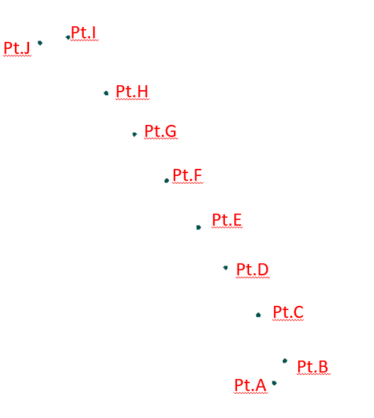

i want to connect each point to the rest of points to find the shortest path between each point and another points if exist .
  • Nov 8, 2020 8:01 AM UTC
  • 192 views
gogopotter90
Forum|alt.badge.img+14
i have several points and i want to connect each point to another points to find the shortest path between each point and another points if exist . as shown as in image .
  1. connect Points A with B,C,D,E,F,G,H,I,J .
  2. connects Point B with A,C,D,E,F,G,H,I,J .
  3. connects Point C with A,B,D,E,F,G,H,I,J .
  4. and connect each point with the rest of the points.
then i would like to cancel the duplicate connection ,as above if Point A connects to Point B ,so it is the same connection from Point B to Point A .so i want to delete the duplicate connection.
i have tried to use line builder ,he connects all points together but when i used it as input for (from ... to )in shortest path finder ,and i used also for the another input network properly noded ,i got no paths output .
so i was thinking that i should use vertex creator instead of line builder ,so i need to create several lines from each point to the rest of points .
then i want to find the shortest length path between each point and the rest of points ,if exist.
please,advise me how could i create connection between points.
FME version 2018
Thanks for help
