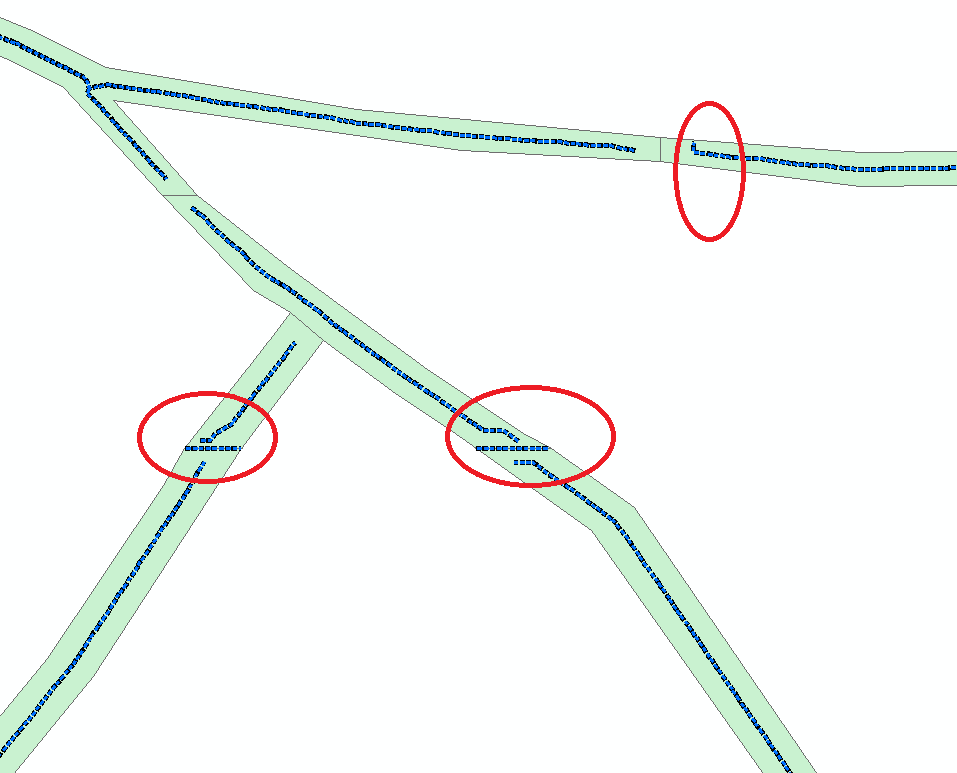

one question how I can try to avoid situations like this (see bmp)
Thx
Francesco
Thx
Francesco
Hi @checcosisani That looks bad :( I assume you're displaying the coordinates on the lines? We're still making refinements to this approximate mode. Can you send us your source data via https://www.safe.com/support/report-a-problem/ ? Thanks!
Thx
Francesco
From the looks of it a Dissolver might help.
