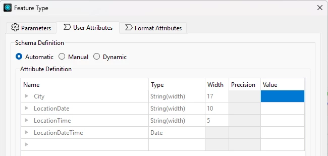

I’m using FME Form 2026.2. I have date and time strings that I need to convert into a date field in ArcGIS Online. It seems like this should be easy, but I can’t get it to work. What format does ArcGIS require to create a date field.
I create a new datetime attribute then write it to a AGOL Feature Service. The field is created in AGOL, but the value are null.

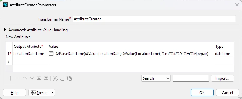

@ParseDateTime(@Value(LocationDate) @Value(LocationTime), %m/%d/%Y %H:%M,repair)
In ArcGIS Online all values are null.

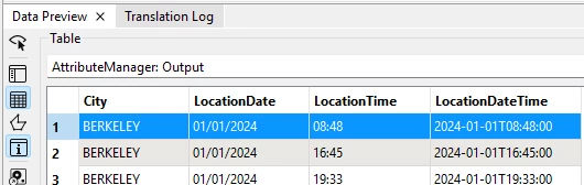

I found a partial solution…
In my AttributeCreator, I changed the value of LocationDateTime
From: @ParseDateTime(@Value(LocationDate) @Value(LocationTime), %m/%d/%Y %H:%M,repair)
To: @Value(LocationDate) @Value(LocationTime):00
Now, I get valid date/time values in AGOL. I googled, “what is the format required when writing to a date field in ArcGIS Online” and discovered that I had to add “:00” to get the valid format of '05/27/2026 17:00:00' (24-hour format).

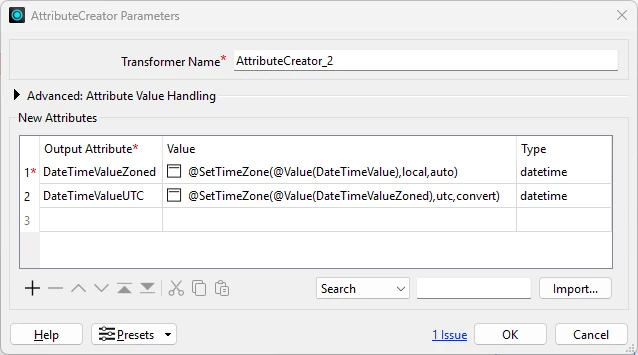

The Handling Local Timezones, UTC, Daylight Savings Time, and Leap Units article referred to @TimeZoneSet which doesn’t appear to exist in 2026.2. I tried using @SetTimeZone in an AttributeCreator shown in the screenshot below, but I couldn’t get it to work. To the left of the OK button there is a “1 Issue” link that does nothing when I click on it.
