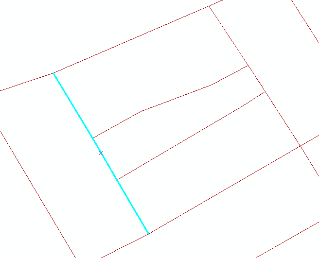

I have a network of lines (representing roads ) and I need to split the line at the intersection with another line. All the features are in the same layer. What command do I need to use?

Hi @helen
Did you try to use the transformer Intersector?
Thanks,
Danilo
  • May 30, 2019 1:43 PM UTC
You could also try a TopologyBuilder

wow it's perfect, thanks

There is more than one way. The LineOnLineOverlayer could also be an alternative.
Forum|alt.badge.img
  • May 30, 2019 3:22 PM UTC
I tried this solution first but I did not have a great success, I'm still in the beginning, maybe in the future it will be a success with this solution also. Thanks a lot for your support.
