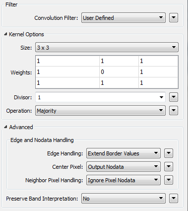

Are the rectangles all equally sized and equally spaced? Because you could turn them into raster in FME with the NumericRasterizer, which does allow rectangular raster cells. Then the RasterConvolver transformer has a Majority option.
Took some experimenting to get the Nodata settings correct, but I think I have it now.
Here's a template workspace that demonstrates the technique.
I hope it's of use.
I hope it's of use.
Eh, I see the link you posted is from dropbox, sadly I can't access dropbox directly, can you post a screenshot, please?
