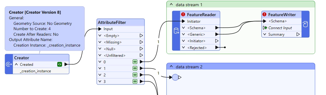

Set the creator to create X features.
Using the default @Value(_creation_instance) will output values 1 onwards
TestFilter on this instance count value. Connect each port to the FeatureReader/SchemaScanner transformer in the order of operations you want

I don’t think I completely understand this approach?
j.botterill
Forum|alt.badge.img+69
  • Aug 18, 2026 6:36 AM UTC
ok, just a plan to manage the initiating of data streams, if you have many featurereader and featurewriters
