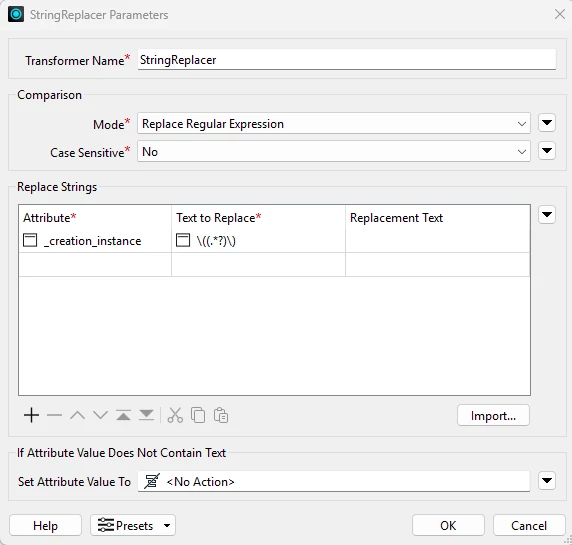

There are many ways to do this, for example you can simply use a StringReplacer:
This deletes all brackets and their content of chosen attribute.

If there’s only a single occurrence of text between brackets possible, a StringReplacer with the regular expression
\s\(.+\)
would do the trick (and remove the space before the first bracket too)
Ah, ​@max_h beat me to it
