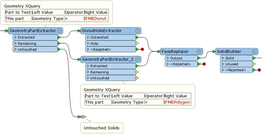

So I have a BrepSolid representing a roof. In the roof there's some holes represented by an inner boundary. I want to remove all inner boundaries of the roof making it whole. How do I remove Inner boundaries from BREP solid?
takashi
  • Oct 21, 2018 11:57 AM UTC
If the roof having holes was a Face derived from a Donut, this workflow might help you.
