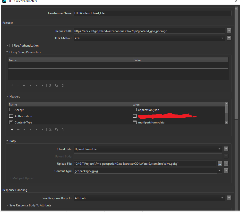

What I see is, that the contentType in Postman and in the HTTPCaller are different. Second why is the UploadBody in the HTTPCaller empty isn't there input which to deliver to the API. And lastly I dont see where you ad the geopackage file or the the path to it so that it can be uploaded.
  • Jan 11, 2024 12:40 AM UTC
Hi @tschoppenhof​ ,
I have set the Content-Type to match exactly what is in Postman and specified the file to be uploaded as shown in the attached picture below and then re-run the process, however, nothing gets uploaded into AMS regardless what the attached log file says.
I noticed that when "Upload Data" option set to "Upload From File" the "Upload Body" tends to be greyed out (whereby it doesn't accept any input for this option).
Regards,
Regards,
Hi deob
I still think there has to be a difference in the settings. Especially in the Upload Body. How does the Tab "Body" in Postman look like?
