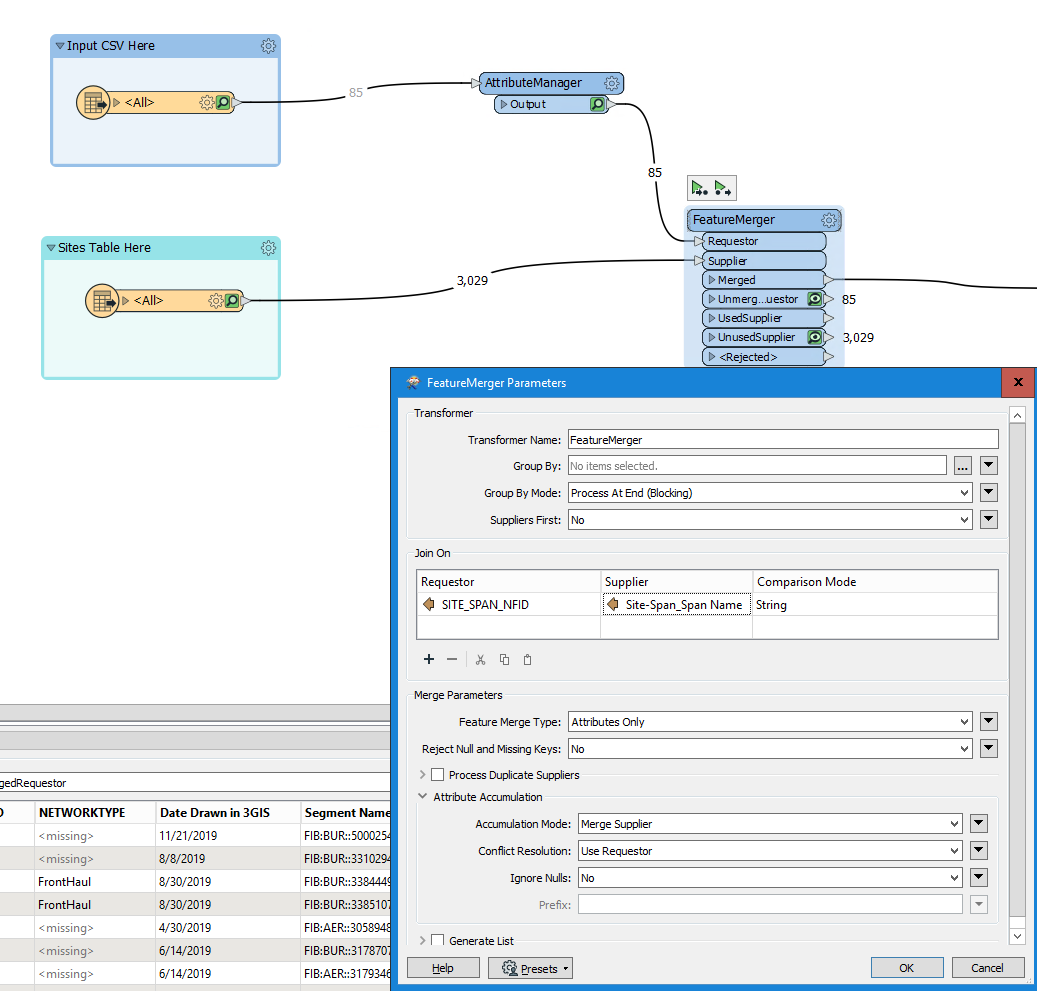

Hello, I am new to FME and could use some help with the FME FeatureMerger Transformer. I have two excel files that contains a matching key field, however I am unable to pull in the 'other' column of data associated to the key fields.

I know it's probably something simple, but I'm not seeing it. I thought perhaps inlineQuerier would help, but I am not versed with SQL.
Essentially I want to do a "vlookup" from one file into the other based off the key field.
thanks in advance!

The Requestor and Supplier attributes should be the column that the key attribute is in for both tables, the additional data will be added automatically as you have accumulation mode set to Merge Supplier (I'm presuming your key field is SITE_SPAN_NFID and Site-Span_Span Name is the field with additional data)
e.g. join on NFID, NAME gets added from supplier

Thank you so much for the reply!
So I have it joined on the key field, and have merge supplier set, however the other accumulated data is not ported over...I'm not sure whyfme help2fme help3

I think I just figured it out!
I had the same field name in both tables...Site-Span_Span Name, which is the field that I wanted filled out in the Requestor. However, I just removed that field from the Requestor table, and ran it through to Inspector and was able to get the accumulated data to populate!

Removing the attribute from the requestor will work, but you can also set the Conflict Resolution (under Attribute Accumulation) to Use Supplier. This will pick use data from the supplier if the attribute exists on both tables
