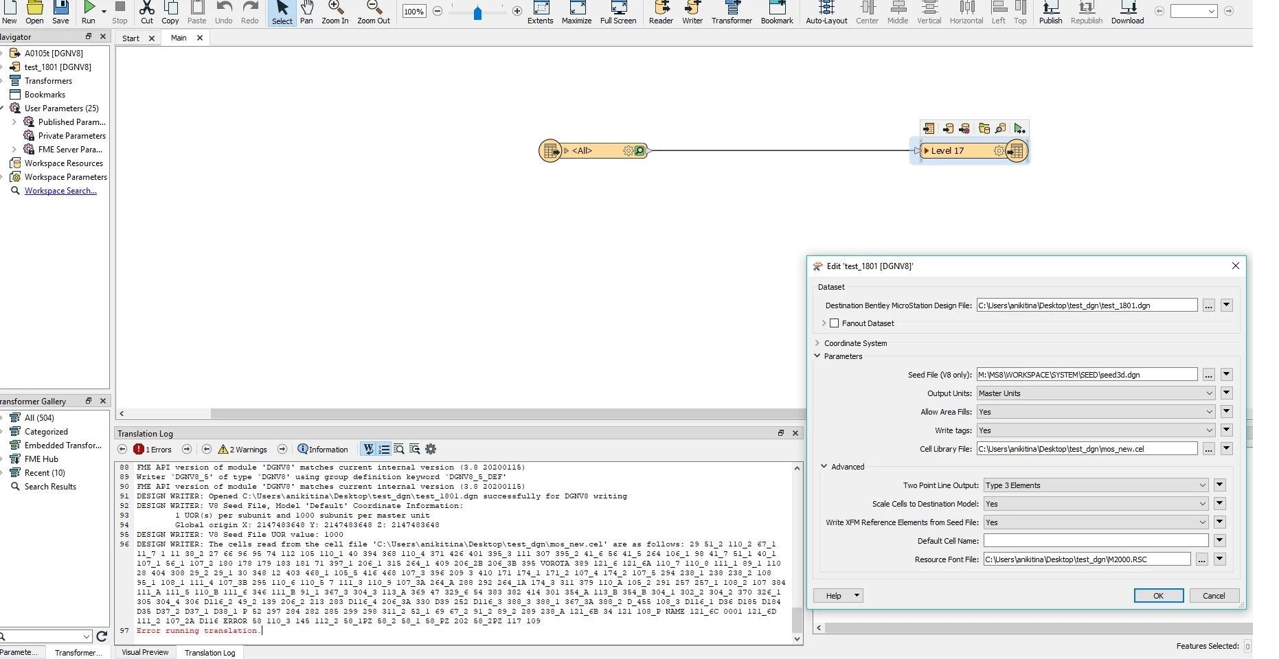

Hello everyone! Maybe someone faced such an issue: I try to write a .dgn file. i want to use my own seed file, cel and rsc. But something went wrong and my workspace doesn't work. i have also tried standard cel file, but there was the same problem.

Hello, use the path to your file with existing styles in the parameter.
dgn_param

Thank you so much for your help. Finally i got the result!
