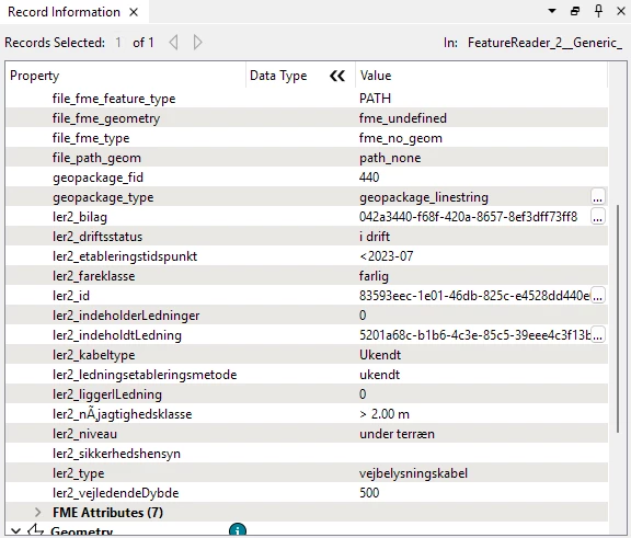

But when I ran it with different datasets, I got undecoded UTF-8 attribute names (Property below) from the Geopackages. Apparently FME forgets to decode these, even in 2025.2.4
It should read “ler2_nøjagtighedsklasse”:

Hi ​@lifalin2016,
If you can please submit a ticket so that our team can look into this further, that would be great! This looks like something our support team should take a closer look at.
When submitting your ticket, please provide a sample of the source data used to produce this issue if possible. As well, please include your FME version and OS. Thank you!
