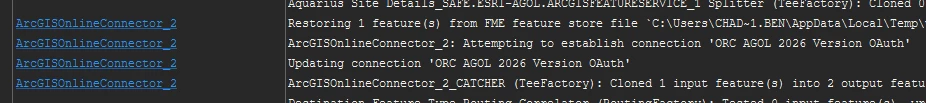

Actually using the ArcGIS OnlineConnector is a different story.
 It works great in 2025 still, and reads everything available to the account:
In 2026 however:
2026 version is trying to use a proxy to connect and eventually just times out without reading anything.
Is anyone else seeing this behavior, and if so how to correct it?  The Proxy settings in both versions of Form are both the same (use system settings).
