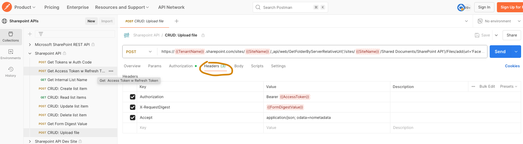

Do you know of any samples out there that show POST operations from HTTPCaller to Sharepoint? I’ve successfully queried a folder with GET /_api/web/GetFolderByServerRelativeUrl('MyLibraryName'), but this GET request doesn’t require constructing a request body, and doesn’t appear to require any special headers. I’m not having any luck with POST operations (like what headers, what's in the upload?)
j.botterill
Forum|alt.badge.img+40
  • June 4, 2025

What’s missing is how do I plug in
{length of request body as integer}
within the HTTPCaller header parameters?

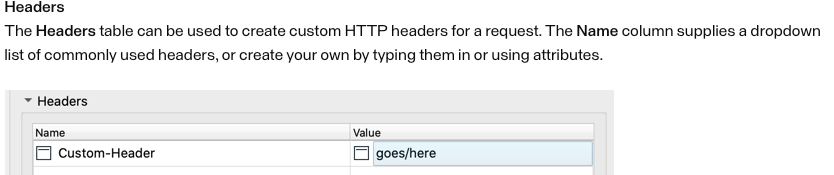

you can dive more into the detail of HTTP-Requests-with-the-HTTPCaller where the Header value goes here
benhanson
Forum|alt.badge.img+2
  • June 10, 2025
I understand where the custom headers go, the issue is how to calculate the request body length in order to populate the value.
